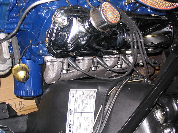

I had mine blasted, then ceramic coated, THEN powder coated with correct cast iron gray. Turned out great!

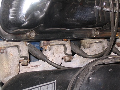

Before:
[Blocked Image: http://troy.krugercentral.com/underhood/manifolds.jpg]
After:
[Blocked Image: http://troy.krugercentral.com/underhood/donemanifolds.jpg]
