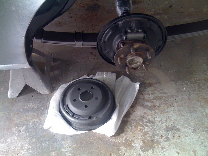

  • Wow, thanks for all the info, I am not really all that concerned about how correct it might be on my 66 GT K Fastback, but more interested if it will physically fit/work.
    I love the sound of the Arvinode exhaust, and while its about twice as much as the "correct" replacement kit from NPD, it is a neat conversational piece and completely reversible.
    I am shooting to have the car back together by early August this year and I am collecting the last bits of parts needed.
    Here is some recent shots...
