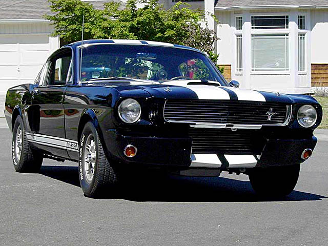

  • I have BFG T/A's 215-60-15's on 15x7 Torque Thrust D's on my K. All 4 fender lips were rolled sometime in the cars earlier life, so there are no rubbing issues at all. Very happy with the ride and handling with this combination.
    Jack
