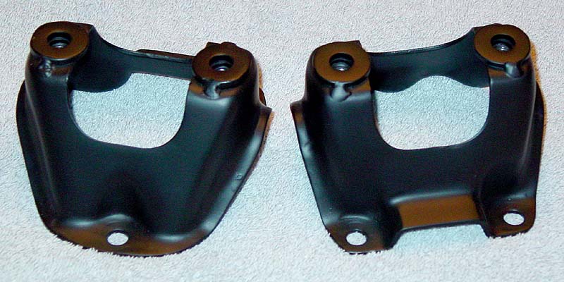

  • Quote from J_Speegle
    The reinforced (washers) front upper shock mounts were something done at Shelby. Seen a fair amount of export cars and none of them had the reinforced shock mounts.
    I've also seen a number of 66 GT350's, including mine, that were in the later part of the production run that originally did not have the reinforced washers either. That's why I picked up a couple of sets years ago. I suspect there was a supply shortage and they certainly didn't want to hold up production for a few washers, just my opinion here.
    IMO it makes more sense for a (presumed) shortage like this to have more of an effect if it was at San Jose rather that if it was a Shelby specific modification. Plus Bo mentioned he has owned Export Mustangs with the reinforced towers.
    Guess more digging is needed on this one.

  • I've had an email conversation with Howard Pardee, 65-66 GT350 SAAC Registrar, regarding this issue. He has an original version of this well known photo and he said:
    "from what I can see it's pretty clear that the washers are there. The export brace and bee hives (that's what they called them) were installed at San Jose."
    That's significant since the cars in the pic are as delivered from San Jose before they were modified at Shelby American, the washer reinforced shock towers seem to have been part of the Export modifications.
    Edited once, last by Mad4HiPos (December 11, 2006 at 11:55 PM).
  • Went back and searched the add-delete sheets and there is indeed (my oversight) a listing (ITEMS TO BE INSTALLED) showing 2- 3829698 Brkt Assy - Frnt Shock Abs. Upper listed
    Interesting that the sheets refer to a number of items we know by part numbers using hardware numbers - like the "export" brace. Don't know why
