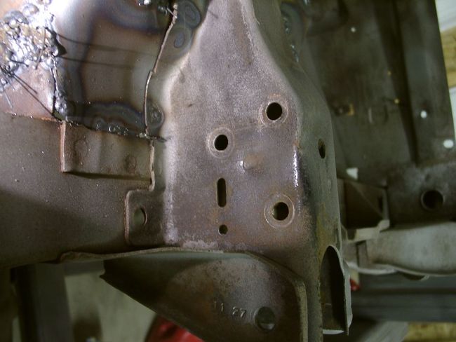

  • here is where the clutch release lever spring
    attaches to the shock tower
    finally found it on my K kar
    and also my son's '66
    one can see i've done a little welding
    to the lower shock tower itself
    iowa
