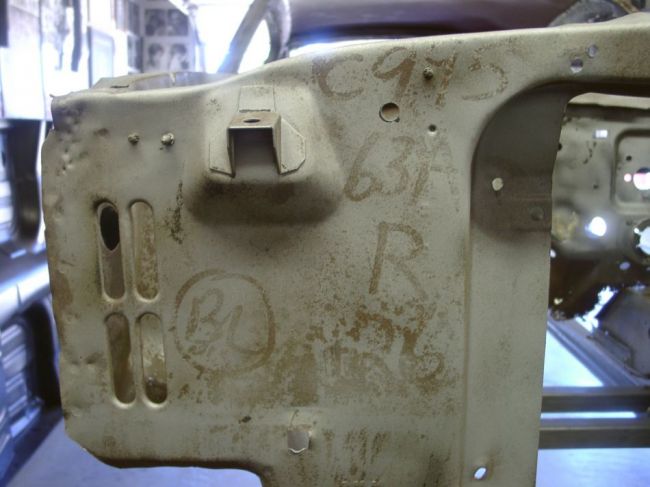

i still can't believe these marks
survived the sandblasting!!
Now, should i save or replace this firewall?

From the looks of the firewall, trying to repair that much swiss cheese, would be akin to performing a practice bleeding session on ones self. A real time waster with a doubtfull outcome.
As fit and function would be practically assured, I'd be inclined to search for a similarly dated donor car production firewall. Same approach for other needed sheet metal parts as well, before going repop. Lots of extra work for sure, but I think it would provide a more satisfying result on the completed restoration.

Quote from 65RangoonAs fit and function would be practically assured, I'd be inclined to search for a similarly dated donor car production firewall. Same approach for other needed sheet metal parts as well, before going repop. Lots of extra work for sure, but I think it would provide a more satisfying result on the completed restoration.
++111
So glad to see this type of recommendation instead of the typical one of buying sheet metal out of a catalog!
I agree, I cut my shock tower out of a donor car too. Great fit!

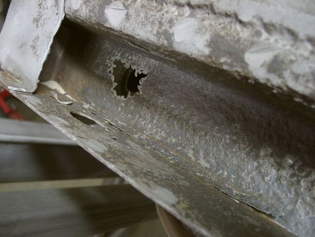

removed outer part of the left front frame extension
here is the inner anatomy of where bolts go thru
outside for a little more blasting to clean up the rust
Q what is the orfice used for where the little rubber plug is?
was it for inspection or to line up the bolt guides?
thanks
iowa

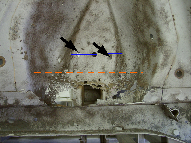

[Blocked Image: http://www.surfacezero.com/g503/data/500/medium/2010_10_30_001.jpg]
Q's
can one replace bottom only part of shock tower (B-L dotted line)?
for better handling, one drills the bottom arm holes 1" lower;
is the rear hole supposed to be lower than the front one?
what is best way to do this?
does anyone know what the rubber plug was for in rear of frt frm ext?
iowa
[Blocked Image: http://www.surfacezero.com/g503/data/500/K_car_L_outer_shock_tower_repair_copy.jpg]

You've got your work cut out for you on sheet metal repair. I would suggest patching that lower shock tower, it's a critical component to the alignment of everything else.
As far as the body plugs, that's a good question. Maybe they were used for alignment of panels. Or, a carry over from a previous design?

will start on that shock tower today
will be using material from another mustang
....and....gulp.....it will be from that '66 C code
but at least it is a Dearborn car too
and i've scrutinized every square mm of it
and can find absolutely no differences in its construction
in comparision, the repro's are quite a bit different!!
