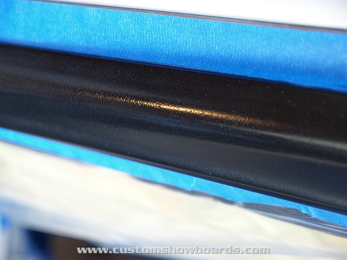

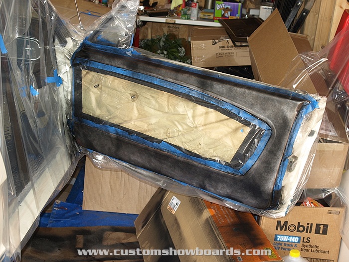

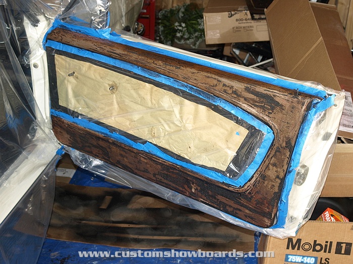

  • I saved the doors for last. Lot's of built up paint, runs, loss of grain pattern, etc. Decided to strip to bare metal and start over. pics below follow progression from start to finish. I know many will dissagree with my method of not using epoxy primer and such, but I'm sharing anyway. I'm not an expert, but it's fun to tinker and learn. We'll see what happens. Fun times indeed.
    after some paint stripper...
    now after some wheel cleaning...

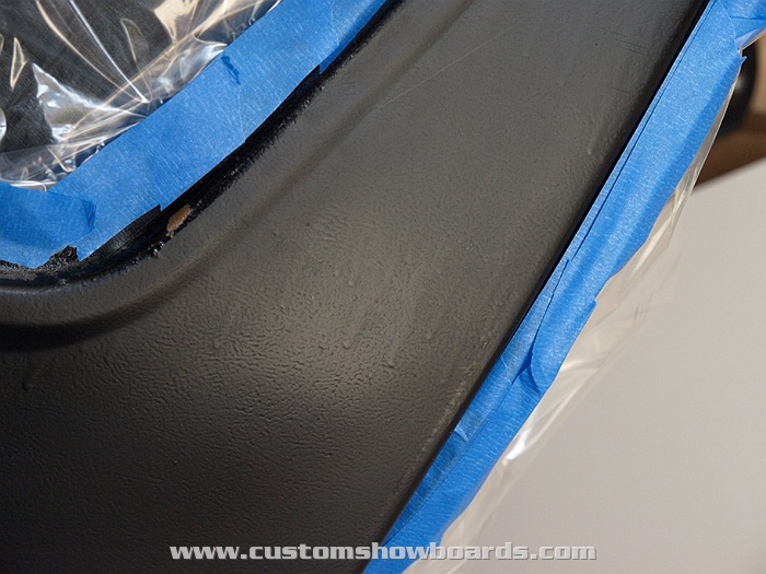

    a dust coat of Krylon (directions say to paint over bare metal, so I used very light coats)

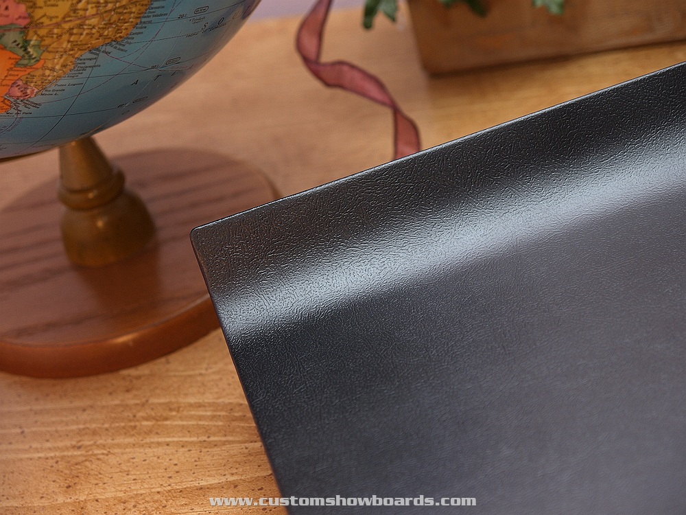

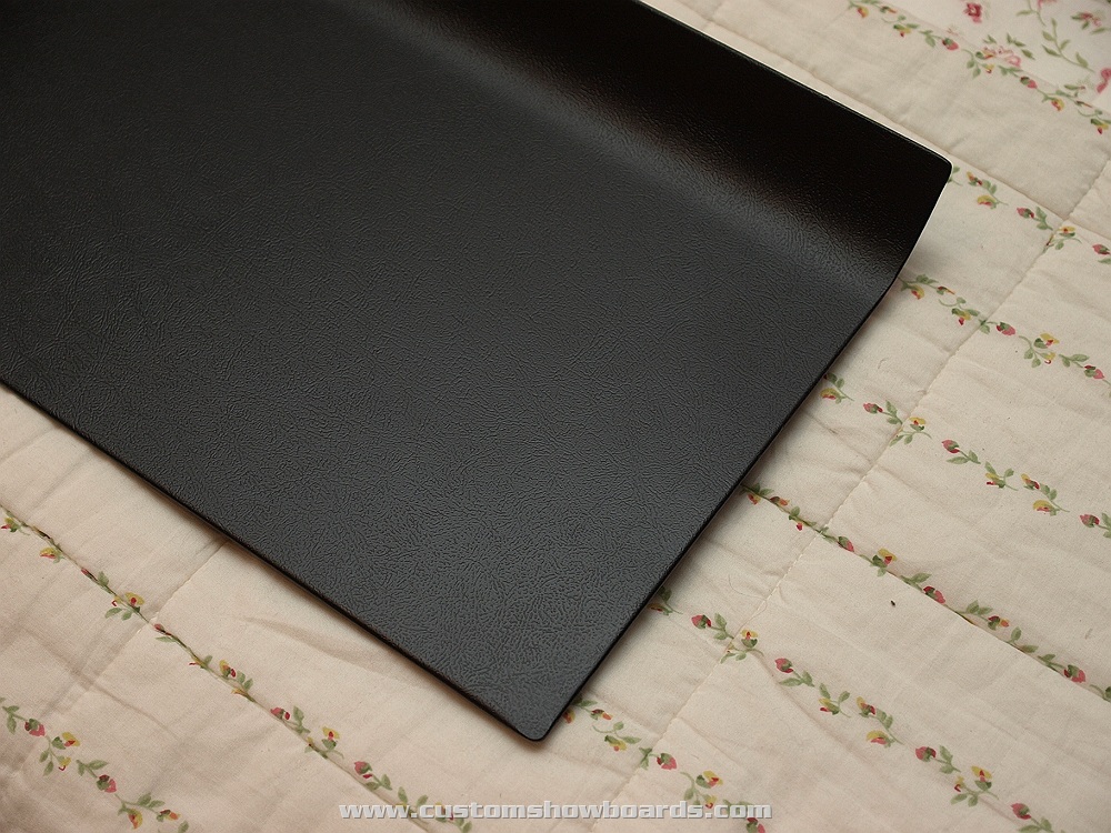

    3-4 coats later...
    detail of grain pattern intact again...
