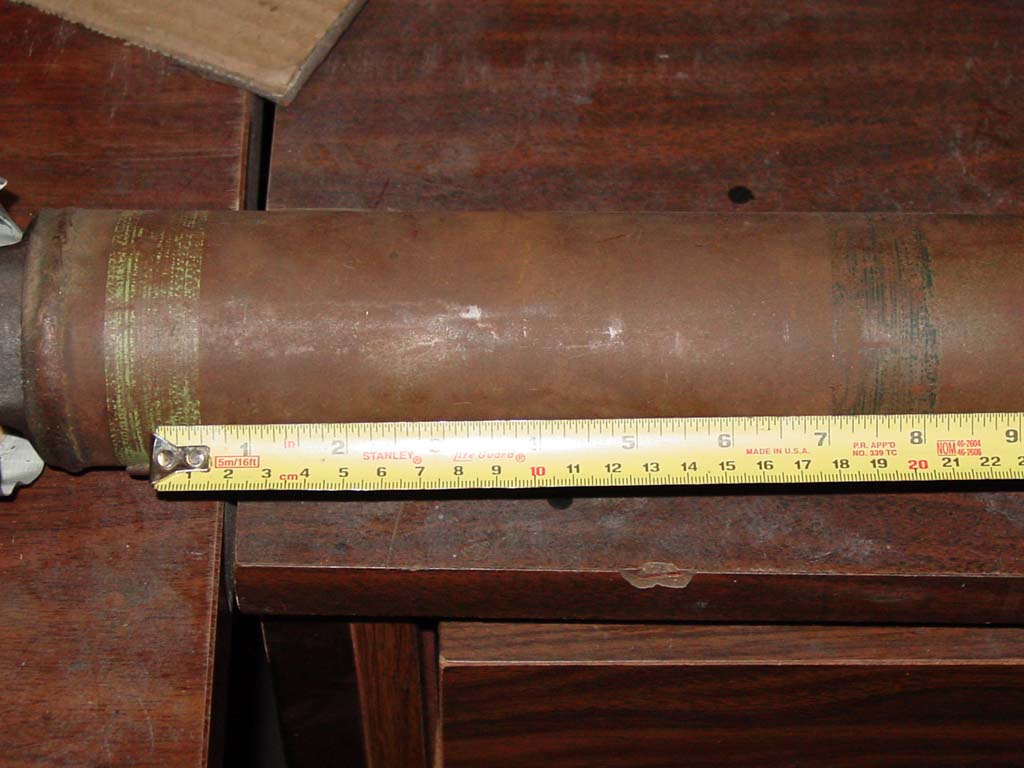

  • Quote from s2ms
    This should help. This is the original tube from my car, stripes to the rear.....
    Dave - Do you know if the stripes on your shaft were original to the car, and if so, what color are they? (Color-challenged vision.)

  • Quote from round2K
    Dave - Yes, the stripes are original, colors are green and white. When I cleaned the shaft the stripes and stencil were amazingly well preserved. I touched them up trying to match colors as best I could, the green isn't as dark as it looks in the pic. I had the shaft retubed because it had some dents and was causing some vibration issues.
  • Unfortunately my original tube pictured above is long gone but I did replicate the stripes and stencil as best I could on the retubed shaft. Here are the measurements which agree very well with calculated measurements made from the picture.
    - Stripe width: 1.0"
    - Distance between stripe centers: 2.25"
    - Distance of the white stripe center to tube end: 4.75"
    - Number width: 0.75"
    - Number height: 1.0"
    I used the number 8 for the stencil measurements.
