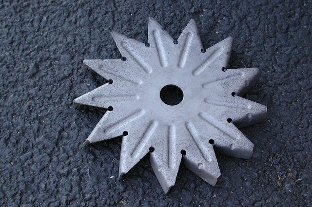

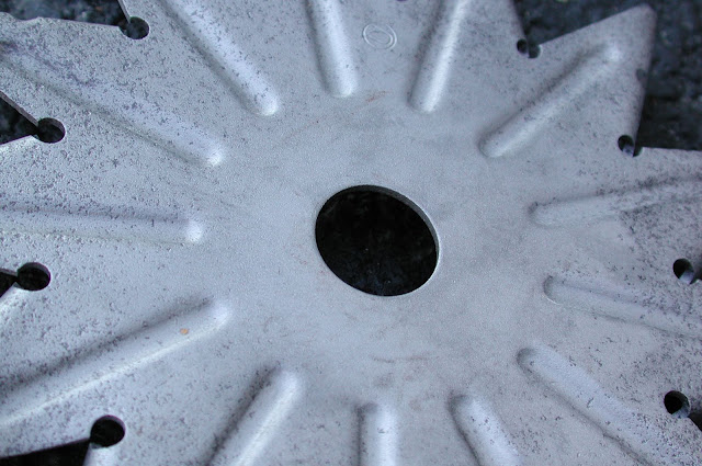

Does anyone have a picture of the fan?
I'll bet Brant does, I didn't realize that there were reproduction pulleys on the market with the correct part number on them either!! (BRAVO again BRANT!!!!)
Yes, I did find a picture of the fan and spacer. This fan is not reproduced.
Here is the later fan that is available. Sorry, picture is not great.
http://www.virginiaclassicmustang.com/65-70-ALTERNAT…NISH-P1318.aspx
Thanks Brant for posting the pictures!! is the spacer unique to the Hipo application?
Quote from 6hypo5conv
It is unique to all of the "earlier" applications that use the flat style fan, not just the HiPo's. Since the fan is flat, there needs to be a spacer behind it. I believe Bob Mannel's Small Block Ford some very nice pictures and information on this.

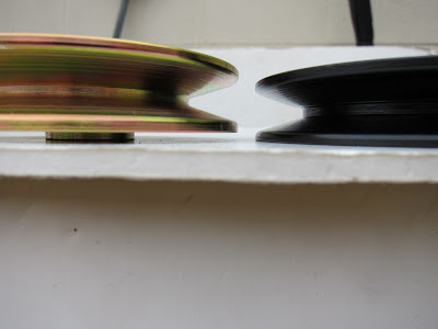

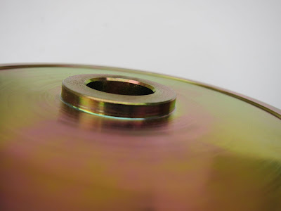

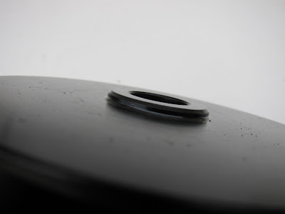

Bo,
If I recall correctly, the original early pulley is not completely flat on the back. It's "built in" spacer is just shorter than the later one.
Later Pulley
Early Pulley
