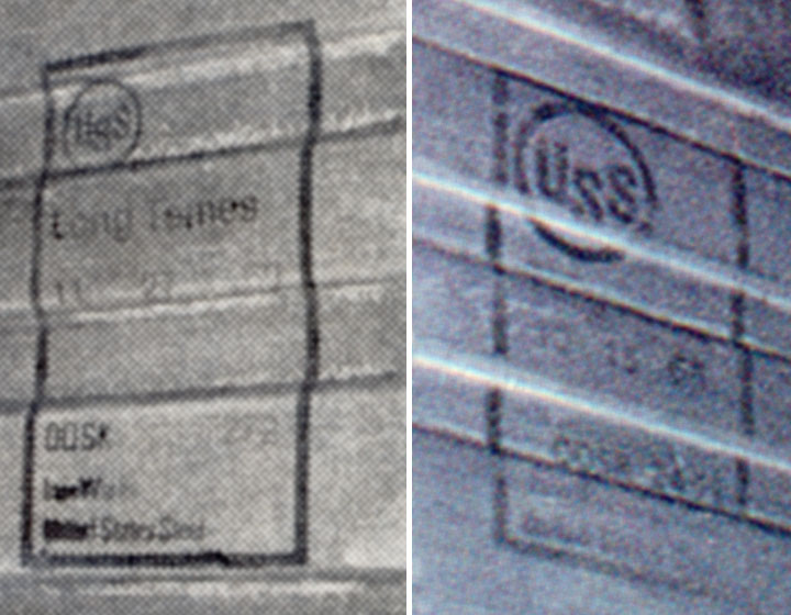

I have a copy of an article from the March 1990 issue of Fabulous Mustangs on undercarriage detailing featuring Bob Perkins' low mileage Boss 302 that has a photo of the tank stamp. Is that the one you're thinking of?
It must be the article I had in mind (or what is left of my mind). Can you scan and post or scan and email the page? Trying to see if the stencil available for the General Motors tank is the same as the logo used on metal used in Ford mustang tanks. Sure appreciate your response.
Also found an article from the Sept. 91 issue of MM about one of the original 66 GT350 converts restored by Drew Alcazar, 6S2377, that has a pic of the tank stamp. I'll scan both at work tomorrow and post them here. The resolution in the photos is pretty bad but may give a general idea of the stamp until someone can post a more detailed pic.
Here ya go, the image on the left is from the Perkins Boss 302 and the one on the right from the Alcazar restored 66 GT350 convert.
Dave: Thank you. Have you or others looked at the stencil available from Inline Tube? It looks so much like the ones you have posted. Please check out their website and give your thoughts. I looked last night in the Sept. 91 issue of MM and could not find that photo. Could you please check for sure the issue of MM that contains the article on the Shelby convt. restored by Drew? I am trying to get a really good view of the logo. The image of the Boss tank also looks the same as the one that was used on GM cars. Looks like we could use this stencil on Mustang and Ford tanks and be correct? Does anyone see a difference?
Any more photos of an original?
John, you are right, the 66 GT350 convert. article is from the Sept. 91 issue of M&F. My bad, sorry about that.
I agree the Inline Tube GM stencil looks a lot like the Boss pic except the USS logo is larger like the GT350 tank pic. I would guess there were several different versions of the stamp.
Dave. do you feel that the marking on the tank in the early Shelby ( the one Drew did) is the genuine article? As you know, my interest is in the 65 - 66 years, and want to use the InLine tube stencil badly, but only if it is correct and that there is no doubt that it is correct. I had hope that it was but have never actually examined that logo. Charles turner has a tank in storage that has the logo as well, and I am waiting for him to post an image. I feel that in 91 when Drew Alkazar was in the restoration business that there was no stencil to replicate the logo and that the tank pictured is in fact the "real deal". Obviously all gas tanks would not have the logo, but enough of them did that perhaps others will join this discussion and maybe check out an old tank and provide us with more pictures. Next we have to work on the date code with I am certain is somewhere in the logo, we just need to figure out how to read it. The guy at Inline told me that when you purchase the stencil they include the appropriate date code with the stencil in the form of seperate little additional stencils. I have a hunch that the sale of the "USS' logo stencil is going to pick up soon. Thanks
John, here's the text describing that picture: "A new gas tank was found that has the US Steel stamping, which was on the sheet of steel when the fuel tanks were stamped out." Your guess is as good as mine if they mean NOS or not. Possibly Ford was still supplying service replacement 65-66 Mustang gas tanks back in 1991?
It's hard to tell for sure but the date code on the Boss 302 tank appears to be "11 27 69" which makes sense. The code on the GT350 tank looks like "10 (1or2)5 65" so maybe it is a NOS OE tank assuming nothing was altered.
