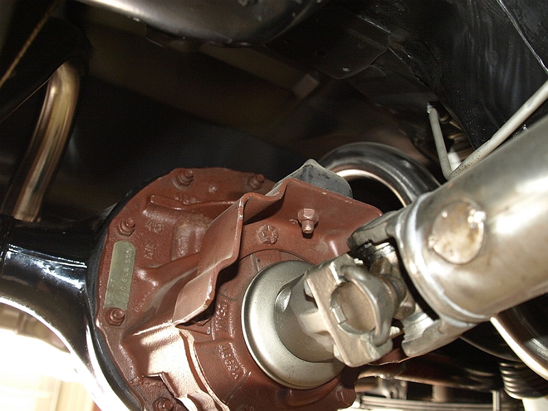

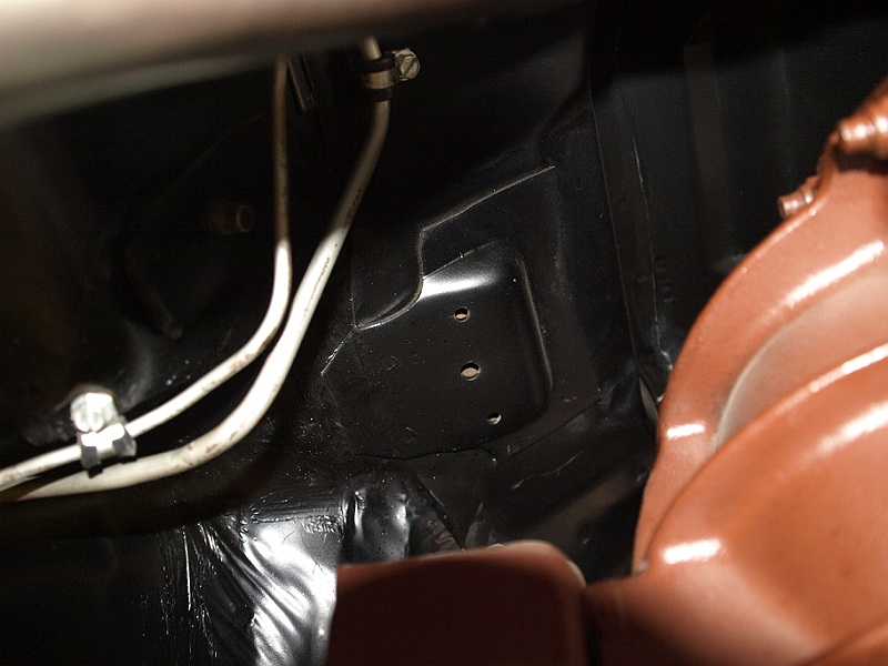

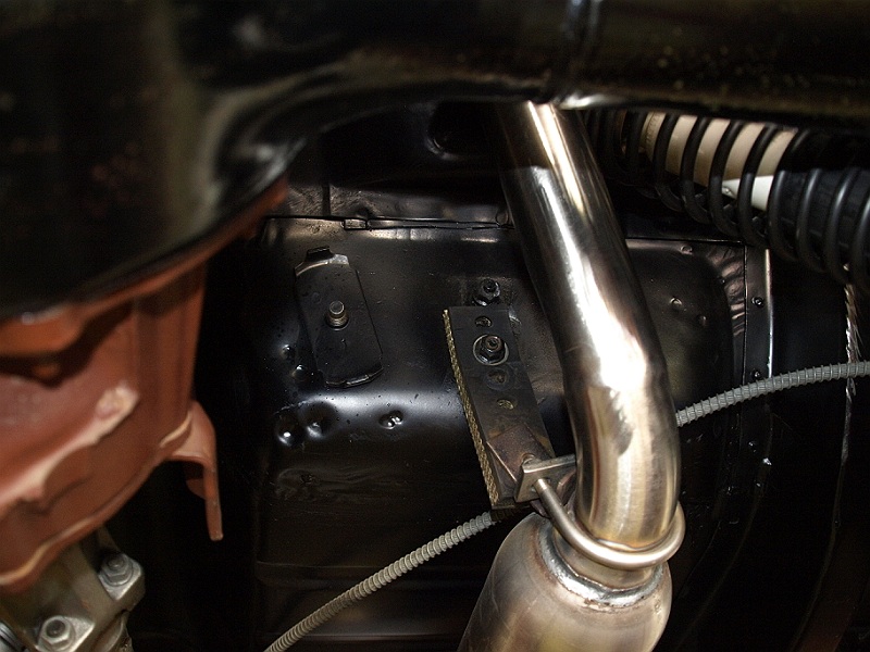

    The above photos show the only areas that seemed to be "saved" from the car. The rest of the floors and all frame rails were replaced. Any comments on these exhaust hanger locations or axle snubber thingy..
    Thanks
