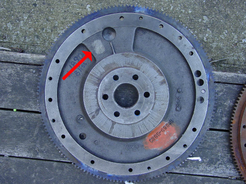

I need a hipo flywheel. (If you have one and are willing to part with it please contact me) I would like to know the location of the Brinell test mark. I have been looking at a flywheel that I think may be correct. It has 3 balance marks 1 at the 1:00 o'clock position and 2 at he 8:45 position (if the center of the counter weight were 12:00 o'clock) It has the correct casting number. No paint visible as it has been cleaned/tanked. Any information on the location and number of the balance holes would be appreciated. Thanks in advance, Dave
Hipo flywheel ID
Dave, the Brinell mark is typically on the rear raised pad, here's a picture. There is also a small BB size depression in the polished area. This flywheel has been rebalanced several times so the balance marks are not as original. Dave
