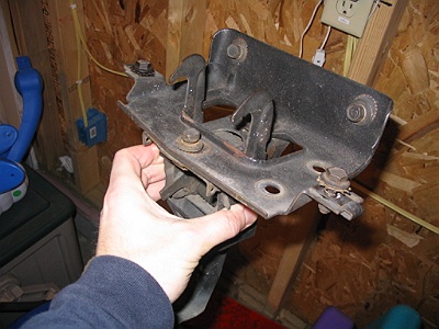

  • 1. Hood Latch assembly: - Still looks pretty good. Some surface rust on the other vertical piece not shown. I can't tell if this was painted previously or not. What is the finish supposed to be? Should I paint it? If so, what color.

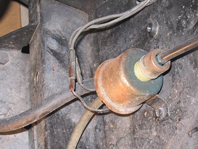

    3. Washer pump - Can this rusty thing be saved or should I replace it. Any ideas on how I can refinish it? I assume the bracket and 2 bolts should not be black or should they?
    [Blocked Image: http://troy.krugercentral.com/underhood/washerpump2.jpg]
  • Hood latch should be phosphate and oil, the brackets were semi-flat black if I remember correctly. Washer pump brackets and bolts were zinc, I doubt you can save the original. Here again I would recommend NOS, the repops are junk.
